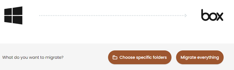

On the next page, answer “What do you want to migrate?” with two source folder options for data migration. Clicking a button continues the data migration process.
- “Choose specific folders” brings up a file explorer for the source content. Navigate to the specific folder by clicking the folder names. Click and Shift-click files to add them to the data migration job. Clicking “Cancel” returns you to the previous screen without selecting files or folders. To confirm your file and folder selection, click “OK” on the bottom right.
- “Migrate everything” selects all files and folders from the source.
