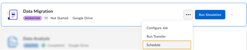

  1. Select Schedule using the the More Options menu.

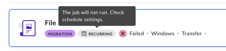

If you specify a condition for running a job, the scheduler will not run your job unless it meets those conditions. For example, if you select Successfully completed, and you stop the preceding job, the scheduler will not trigger the job because the preceding instance of that job did not successfully complete. You can check if the job meets the scheduler’s criteria to run by hovering over the scheduler pill when the job is not running.

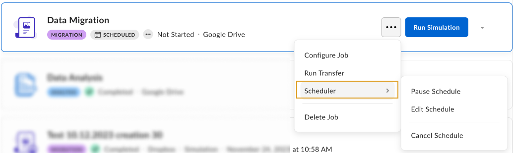

Manage scheduled jobs
You can manage the already scheduled jobs using the Scheduler menu.
migration-scheduler-png
The options allow you to pause, resume, edit, or cancel the schedule.

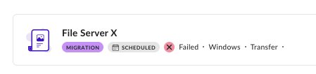

When the job fails, it will receive the Failed  status on the dashboard. Because the job fails before it even starts, it won’t have any job history, so you won’t see the job failure in the report section of Shuttle. The only place that the job failure will be listed is in the job card:
failed-job-png
If you go into Run History for the job, you will still see any previous runs of the job, but you will not see any details related to the scheduled job failure other than the Failed tag in the job header, because the job did not actually run.
